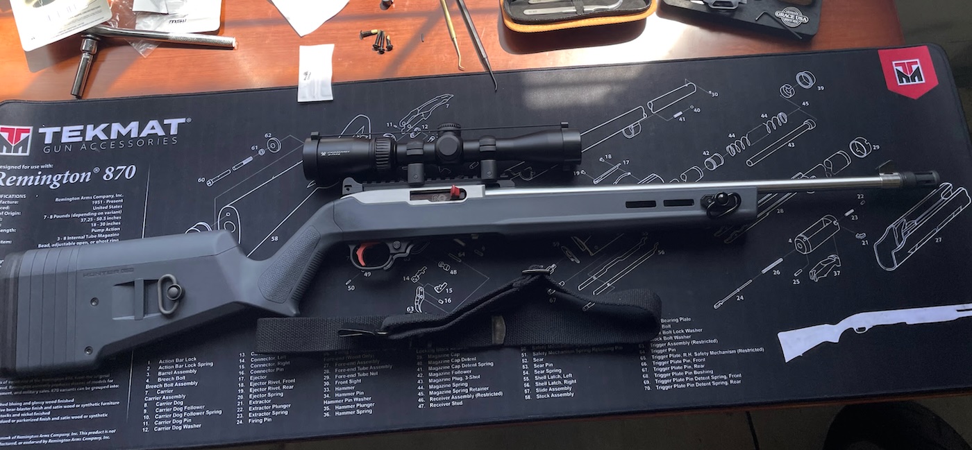

I'm preparing a Ruger 10/22 60th anniversary edition for the upcoming course in Piru and got a few questions concerning the proper sling.
The rifle I got is this one: https://ruger.com/news/2024-01-01.html
This last weekend I installed and zeroed a Vortex Crossfire II (2-7x32) scope on it and I was pretty happy with the results (shooting from bench at 50 yards with Federal copper platted hollow point 36 grain value pack).

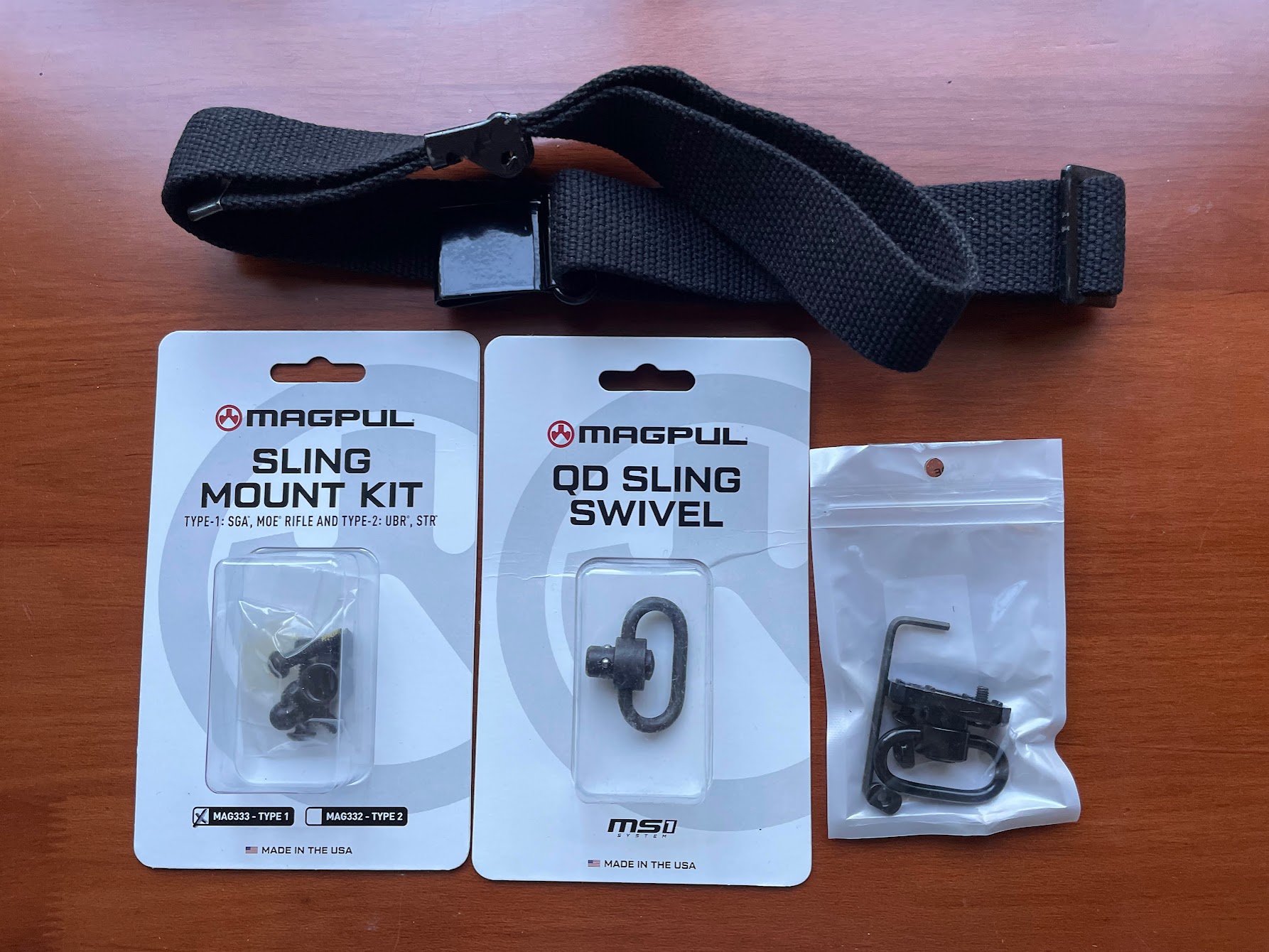

The question I got is what do I need to buy to be able to mount a sling on this little rifle?
I've found reports of people buying the magpul sling mount kit 1 and 2:
https://magpul.com/sling-mount-kit-type-1.html?mp_global_color=118
https://magpul.com/sling-mount-kit-type-2.html?mp_global_color=118
Plus the dual sling:
https://magpul.com/ms4-dual-qd-sling-gen-2.html?mp_global_color=136
Would that combo work well for the course? If negative, what do you guys suggest?
I was looking for something that would be easy to install on the X-22 magpul stock. I don't have
any relevant experience gunsmithing and would prefer something that is 'plug n play' on the stock.
The little 10/22 60th anniversary edition:

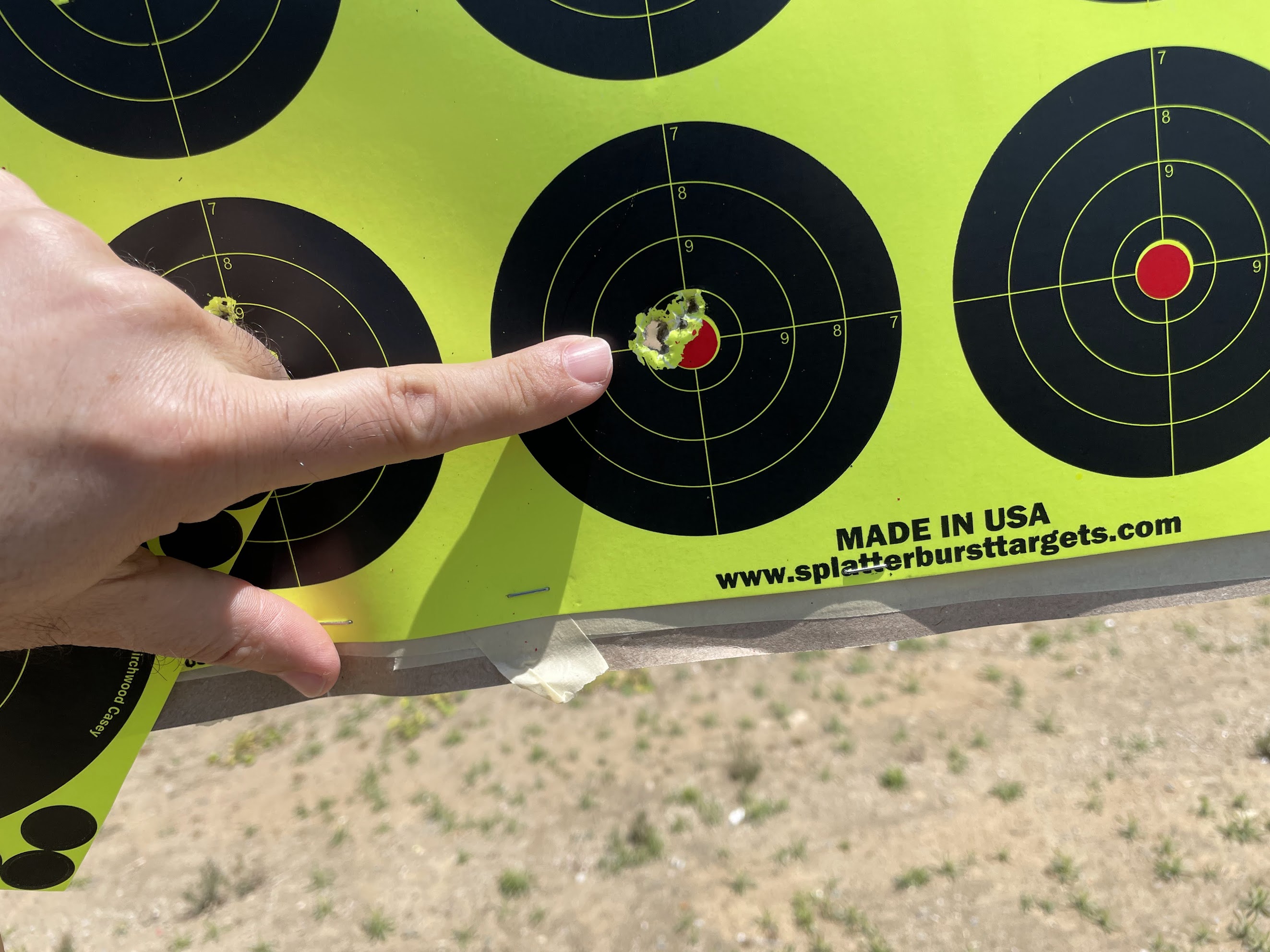

Best group at 50 yards:

For the sling itself, the best Magpul product would be the RLS; I don't recommend any of the MS-series for use as shooting aids as you'll learn at Appleseed.
For the attach hardware on this stock, you want something that will put a swivel on the bottom front M-LOK, and then the Type-1 kit on your dominant side. Simplest thing is MAG606 for the front, and then assemble the sling onto two MAG540s.
Nightpoison
As Mmirate has pointed out the best option for a Magpul sling is the RLS(Rifleman Loop Sling). There are a few other slings, non Magpul that do a fine job for shooting from the sling. Most slings, however are geared towards other styles of shooting or just don't work for supported shooting.
With that said the go to Sling is the USGI Cotton Sling. There are several very good reasons why Appleseed recommends and instructs with this sling.
There are those, students and instructors, who use the Magpul or other variety of sling, but for me, the USGI is the gold standard.

If you look on the bottom of your stock, you'll see that there are two little dimples (one at the front of the stock, and one towards the rear before the spacers) that are designed for you to install 3/8" sling studs. That will allow you to attached sling swivels, which will allow you to use your choice of sling.  I've done this for both of my 10/22s and I used USGI cotton web slings.  These are the studs I used:
Swivel Studs
Brownell's carries something similar, but they've been out of stock when I was in the market for them.

@all: all good advice, I really appreciate it!
@mmirate: do you mean this sling: https://magpul.com/rls-sling.html?mp_global_color=118
And this mount: https://magpul.com/m-lok-qd-sling-mount.html?mp_global_color=118
With two of this swivels: https://magpul.com/qd-sling-swivel.html?mp_global_color=118
Finally using the Type 1: https://magpul.com/sling-mount-kit-type-1.html?mp_global_color=118
Is that all I need? I'm planning to do an express order to be able to have everything ready to go ASAP.

Amazon (love it or hate it, whatever) links to get you squared away for an X22 stock
Sling: https://www.amazon.com/M1-Garand-Cotton-Sling-Black/dp/B0CSKJ51NL?psc=1&pd_rd_w=VVUKd&content-id=amzn1.sym.55c0153f-1fb7-42ff-8241-d1c0f3732289&pf_rd_p=55c0153f-1fb7-42ff-8241-d1c0f3732289&pf_rd_r=DWYW2TF09QZ4S4XY2YCM&pd_rd_wg=Rf71r&pd_rd_r=dfea1ac5-b71b-4636-8ffc-cb917aba9775&ref_=sspa_dk_detail_1&sp_csd=d2lkZ2V0TmFtZT1zcF9kZXRhaWxfdGhlbWF0aWM=
Most commonly used sling at Appleseed
QD MLOK socket and swivel: https://www.amazon.com/REERON-Point-Sling-Mloc-Mount/dp/B0B4K7G4VJ/ref=sr_1_1_sspa?crid=HNEHFL6YCL7Y&dib=eyJ2IjoiMSJ9.MMsrXpSj53j3ra8bfH3-R5UYwE-gxsX5Gvk1378ZI65XaFiA7rHtafd7OLOAAxc-34SvVlYZcKyGIeU5fswEzTfX6-iNyGDc2CEsfYomVTDISRZISdIS5yXlx8t5181-d6BGYh_fGZhYU8IPM_6LDkVBsmwcMsBLe9ngzNivqfUwmDVbLW8sNmblrjW0tu134HQuxwn7mLvQjXu_4BmKfptStj_ozyA6fyeT5kKVL84phgNh77wtpMXggbReso9p-Ho6OXIDZvTHk34LD87YpiVaEYbPX0-HxwcgtuP9tHY.2u2cRzBmcsBWIGl_9z7o5CkfIN7dUcatIQ6vzFktARo&dib_tag=se&keywords=m%2Blok%2Bqd%2Bswivel&qid=1746812537&s=sporting-goods&sprefix=m%2Blok%2Bqd%2Bswivel%2B%2Csporting%2C107&sr=1-1-spons&sp_csd=d2lkZ2V0TmFtZT1zcF9hdGY&th=1
Mount this MLOK socket under hand guard in one of the open slots, loop the sling into the QD swivel and reinstall keeper
QD sling cup for butt stock: https://www.amazon.com/Magpul-MAG333-BLK-Sling-Mount-Kit/dp/B009287QF8/ref=sr_1_1?crid=SRZ1DT64ZZIT&dib=eyJ2IjoiMSJ9.6wmZ9f2F9HwQgknOKzDIP9yPBbfDjSgQ8uxMSSuLyAqL6ELu3crnP2yYedk0jA6vGRUThZKvcELXvrkVaCxZaRQohy1VXnjHNU_2FqxH8Kipb9mql5vdtTt0_wA7DFrvPpOgF1Tv2fJCODbcOfizTLix7osejHRENiYV5of_pgSwsiyLS0oF6tkTXfPcC43WoTa9RqBLTRb4dKHP2sEB9yXb6wf42NLSdOP042irGoj317zDt--1zdiSfNOGhmF471DqeVO15k1K8iUigNx23PJnH5E_g22EwGqHW8ew1Qs.v5_iby1G8umU4AG44JqznEj4KvgEyUFHtgJYGNO_R1c&dib_tag=se&keywords=magpul+sling+cup&qid=1746812650&s=sporting-goods&sprefix=magpul+sling+cup%2Csporting%2C107&sr=1-1
Mount this on the butt stock
QD swivel for butt stock: https://www.amazon.com/Magpul-QD-Quick-Disconnect-Sling-Swivel/dp/B00HKBSQ26/ref=sxin_16_pa_sp_search_thematic_sspa?content-id=amzn1.sym.87b1f643-33a9-49d2-948f-44f2ccfe0508%3Aamzn1.sym.87b1f643-33a9-49d2-948f-44f2ccfe0508&crid=HNEHFL6YCL7Y&cv_ct_cx=m+lok+qd+swivel&keywords=m+lok+qd+swivel&pd_rd_i=B00HKBSQ26&pd_rd_r=f4129532-4339-402b-8267-abdb211c4b73&pd_rd_w=A6w4T&pd_rd_wg=7ClFz&pf_rd_p=87b1f643-33a9-49d2-948f-44f2ccfe0508&pf_rd_r=RM06SCYG9GKWGD7VMRBG&qid=1746812537&s=sporting-goods&sbo=RZvfv%2F%2FHxDF%2BO5021pAnSA%3D%3D&sprefix=m+lok+qd+swivel+%2Csporting%2C107&sr=1-4-6024b2a3-78e4-4fed-8fed-e1613be3bcce-spons&sp_csd=d2lkZ2V0TmFtZT1zcF9zZWFyY2hfdGhlbWF0aWM&psc=1
Use this to secure the J hook of the sling on the butt stock for hasty sling
My 2 cents.

That's all correct, but Amazon and other retailers will usually get you better price and quicker shipping - kudos to B.C. for putting you together a shopping-list.

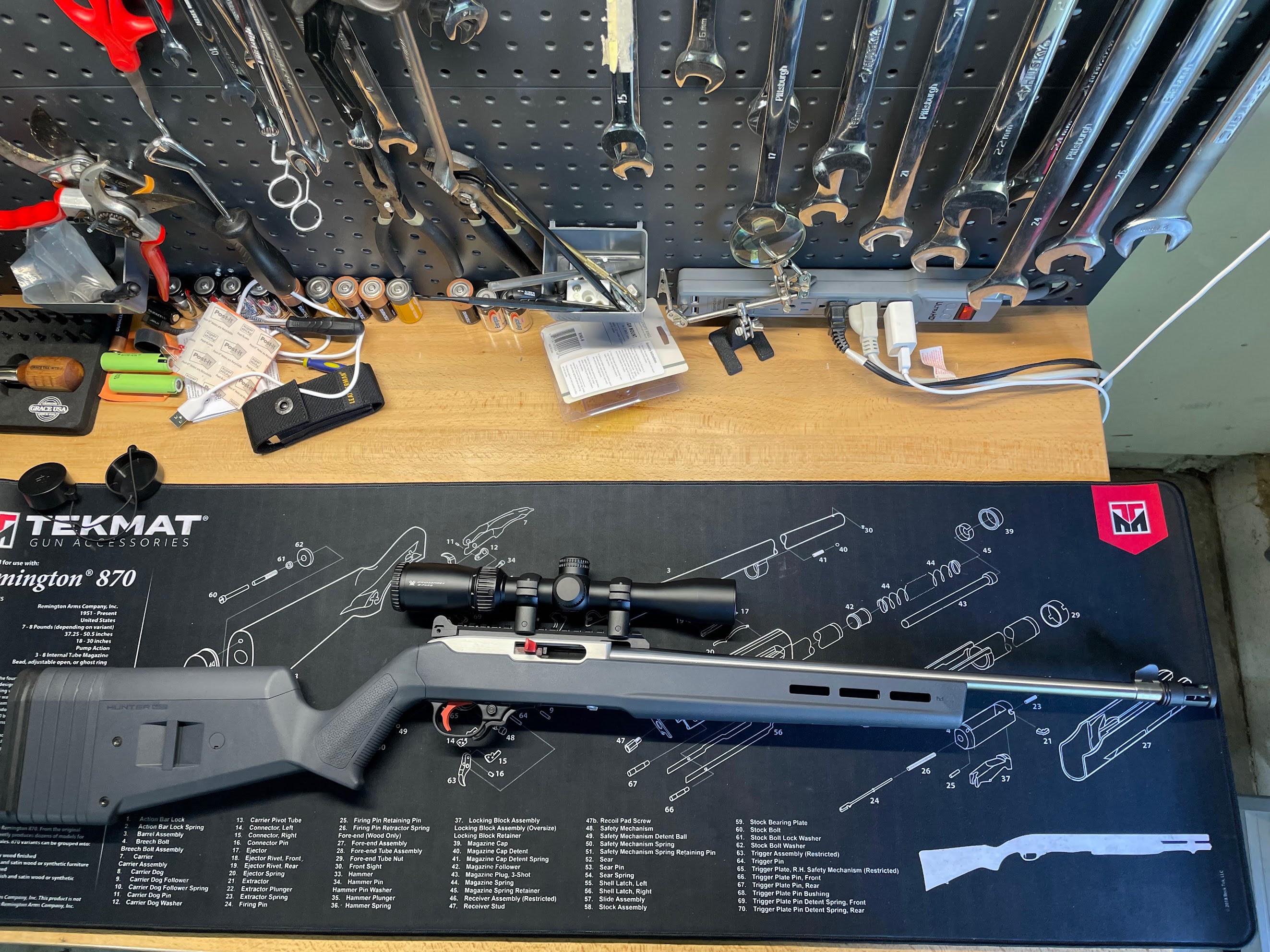

a) The Ruger 10/22 60th anniversary edition worked so well! I forgot to bring the tools to be able to clean it for the second day, I only used an oiled rag on the it and a bore snake i.e. didn't field strip to clean the action.
Even with rainy weather on first day and windy/dusty weather on the second day it never skipped a beat i.e. no failures to feed/eject, etc.
I think the ammo I've used helped a bit: Federal Copper plated hollow point, BYOB (Bring Your Own Bottle):

b) The buttstock Magpul QD Swivel unfortunately is slightly shorter to be able to attach the USGI sling I bought.
As a result, I used the sling tied to my left arm instead.
Perhaps I can try to file 1mm or 2mm out of the sling attach point to make it fit the swivel? Or perhaps I could order a sling that would actually fit? Dunno.
c) The swivel + m-lock (https://www.amazon.com/dp/B0B4K7G4VJ?ref_=ppx_hzod_title_dt_b_fed_asin_title_1_0&th=1) worked well, but I originally mounted it on the right side of the rifle.
As a result, it would twist the front of the rifle when I used the sling to shoot.
Fortunately our instructor (rhymes with 'Mob'  ;)
was able to mount the m-lock attachment to the bottom of the rifle which improved things quite a bit.
The sad part of the mount is that it is made of 'high grade chinesium' and one of the bolts is no longer good. I guess I got what I paid on it in the end (i.e. 9 bucks).

Sounds like you need to change out the rear sling swivel on your stock, but are otherwise pretty good to go! Good luck at the RKD, and have fun  :)
